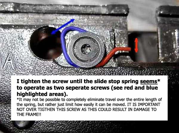

    Slide locking back prematurely (aka locking back with rounds still in the magazine):
    I first thought this is to be an operator issue, so I removed some material from the stop lever to make it smaller and reduce the chances that I was inadvertently hitting it when the gun recoiled (see above). I'm not sure how much this helped as the problem still persisted.
    The slide stop on my CW45 was always very easy to remove from the pistol; so much so, that if a round nose dived enough while feeding it could pop the stop out from the frame. My first fix for this was to remove some material from the stop where a nose diving round would impact it. This did fix this issue, but I still had intermittent problems with the slide locking back with rounds still in the magazine. I decided to also remove some material from the stop where rounds might contact it when feeding from the magazine. This has fixed premature slide lock problems in other Kahr poly guns, http://kahrtalk.com/showthread.php?t=6066 (you might also want to see this video: http://www.youtube.com/watch?v=ph41eu-7IgI ), but was not quite as effective in my gun.
    I now believe that the slide stop spring may have played a greater role in both issues than the stop itself
    . I had an extra slide stop spring and decided to install it to see if it made any difference in how easy my stop was to remove.
    A note here: if replacing the spring, don't remove the screw holding the spring and washer in place completely out of the frame; just loosen it enough to remove the spring. This will greatly reduce the chances of stripping the threads in the polymer frame. (see how I did it here:post #25 in this thread.)
    Upon removing the spring, I compared the old and new: finding that that old had some wear marks on it where the stop contacted it, but otherwise they were identical. After installing the new spring
    , I did some experimenting with the screw that holds it in place (Note: I was very careful when doing this so as to not over torque the screw and damage the frame). I found that by tightening it just to the point that the spring seems to operate as two distinct springs (where before, the whole spring seemed to move easily as one) made for a much tighter fit of the slide stop. I say seems becuase you may not be able to eliminate all movement along the length of the spring, but just limit it how easily it's done. YOU DO NOT WANT TO OVER TIGHTEN THIS SCREW. I then loosened the screw until the spring would move freely as it had done before; this resulted in the stop being as easily removed as it previously had been. I played with how tight the screw was until I found a median that I liked; leaving it just tight enough that the springs travel seems to mimic two distinct springs and the stop is tight enough that I need to use something to start it out of the frame (though I can do it by hand if need be). My CW45 functions perfectly with the spring adjusted this way: no more inadvertent "lock backs" or the stop being pushed out of the frame by nose dives. Again, this is just what worked for me and how it did it, not how to do it.
    Here's a video to better explain (hopefully) how I tightened the slide stop spring screw: http://www.youtube.com/watch?v=c50P7HCAATo
    Later on: I found this posted about tightening the slide stop spring:
    I also called tech support to get the proper way of setting the screw and they said:
    The spring looks somewhat like a G and that the screw should be tight enough that the top and left part of it do NOT move. If I understood him correctly, the bottom perhaps from
    6 o'clock
    and going counter clockwise should move and that the rest should be clamped down. (http://kahrtalk.com/showpost.php?p=3...stcount=post20)
    This seems to verify what I found when replacing my slide stop spring.
    FWIW: I've been running my larger slide stop (unmodified lever) since replacing the spring (and tightening it as described above) and have not experienced any more premature locking back of the slide (or the slide stop being pushed out by nose dives).
    Slide stop popping out:
    Slide stop pops out when firing or chambering a round.
    Tightening the slide stop spring screw (as detailed above) may solve this issue for you.
    to be continued...
