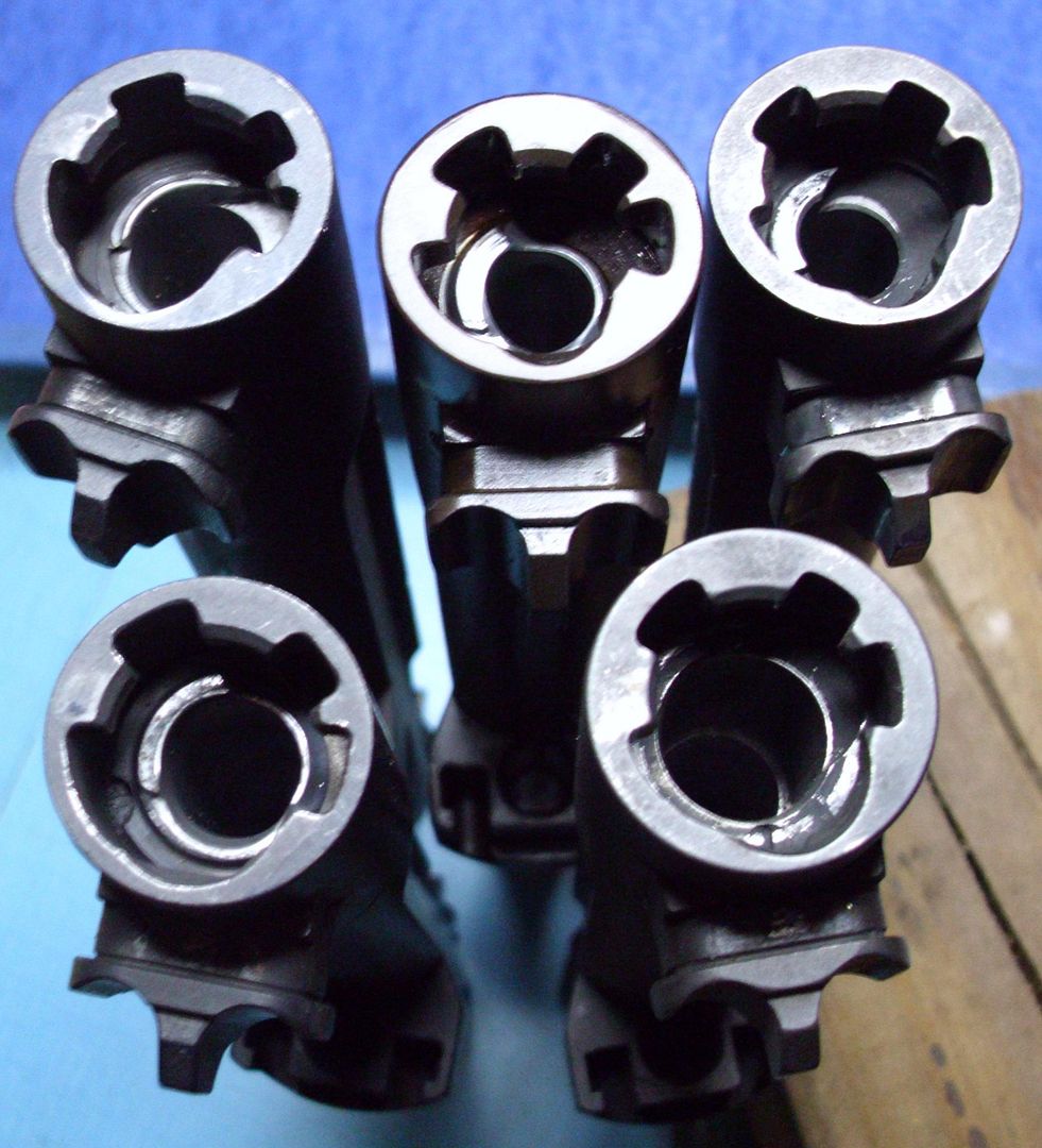

    Well, today (Monday, 2-12-2018) I received the replacement barrel from Magnum Research. Cosmetically it looks fine... no issues like the other barrel. Functionally, it is the same however... non.
    Most of the time, if you drop the slide, the bolt gets a couple hundred thousandths into the barrel and jams/seizes/locks up etc. I am usually able to force the slide backward hard enough to get the bolt free of the barrel, but sometimes you must pull the barrel from the frame to free it.
    It will not load a round from a magazine... at all. It isn't the round hanging either, because after the bolt hangs up in the front of the barrel, you can hear the round slide in and out of the chamber.
    For the curious, here is how I quick checked the issue.
    First, I pulled the barrel and slide off, and I can easily, cleanly push the barrel into battery, with no frame involved.
    Second, I reassembled the gun without the gas piston and recoil springs and the bolt still binds up completely.
    Third, I pulled the bolt and there is no slide to barrel contact, so that isn't it.
    Fourth, I pulled the extractor and replaced the bolt, and it still binds exactly the same.
    I can see where a couple of the barrel lugs are gouging my bolt, so I know there is a LOT of contact...
    I could send it back for a refund... but then I wouldn't be me. I am going to attempt to fix it... here is why.
    1. Mk XIX .357 Magnum 10" barrels are hard to find at most any price.
    2. Quality in other areas... like the gas cylinder diameter (as with all two part barrels I have, it is perfect and exactly the same diameter as my 1993 Israeli made .50AE, so no custom gas piston needed for this barrel.), the barrel fits both of my frames to perfection, and last near perfect chamber... the polish is far better than my US made current production barrels in all three calibers. Nothing to improve there.
    3. I believe the problem is simply fit, and nothing fundamentally wrong with the barrel.
    I still don't get why the design is SO different from all my other barrels, US or Israeli, ancient or modern... why is this one barrel different? WHY change from what works... the irony that the very area that is changed seems to be the problem area.
    Just look at this!
    (Left to right, top row... 10" .44 Mag, 10" .357 Mag (new), 6" .357 Mag, bottom row... 10" .41 Mag[MkVII], 10" .50AE)
    The point of this picture is the lug depth variation on this one barrel... especially compared to the 6" .357 to the immediate right of the problem barrel.
    The first step to repair/fitting will be to clean a bolt and the barrel thoroughly, get some DyKem on them both and see where they are hitting/binding, and see where to go from there.
    As this seems to be a non-isolated issue, I will post what I learn here just in case someone with the same issue has a desire to fit the barrel themselves, it might help.
    The good part is that I have other working .357 Magnum barrels to compare dimensions to.
    MrBlackCat

    Update: Resolution...
    As I had suspected a little, and hoped a little, the issue required only simple fitting.
    I cleaned the barrel and bolt, applied DyKem and re-assembled the gun... I cycled the slide and let it jam up good a couple of times. I then removed the bolt from the slide and was presented with only two contact points, but they were substantial. A close look with a magnifier showed tiny metal shavings on the bolt. These shavings were left there by the barrel lug tips, and there is almost no gouging or damage to the bolt. The barrel material is a good bit softer than the bolt, so all is ok.
    An important note... this post is referencing the replacement barrel. In the pictures above, of the bolt, you can see two places where the FIRST barrel gouged/scraped the barrel lugs... the new barrel hit EXACTLY the same. This could mean that other barrels from this batch might only need this tiny bit of fitting to work perfectly. This entire process took about an hour... except for pouring ammo through it for testing after the first and only adjustment... that took another hour.
    In the image above, you can deduct which lugs were trimmed and re-polished... but here is an image marking where I removed a small amount of material.
    Basically I rounded these sharp corners with a diamond bit, then polished them smooth. I didn't remove much material really... for reference I maybe made roughly a .020 radius on the marked corners. This made 100% clearance to the bolt.
    One thing I did that I do on all my barrels that this barrel did need... I used a round brush in a Dremel tool to reach behind the barrels locking lugs and polished the inside of them. They needed it. This would probably correct after a good number of rounds is run through the gun, but why not just polish them? I do this to almost all my new barrels, but the used barrels (with the exception of one) don't seem to need it.
    So I took it outside, did a 9+1 and slowly fired the rounds (Winchester Super-X)... then I put 100 rounds of Aguilla through it. Flawless... and you can not limp-wrist this barrel... and I have not custom fit a gas piston for this barrel, as it didn't need it. The gas cylinder is absolutely perfect in dimension to my other Israeli made barrels.
    While 110 rounds isn't a thorough test by any means, I am confident all is well with this barrel.
