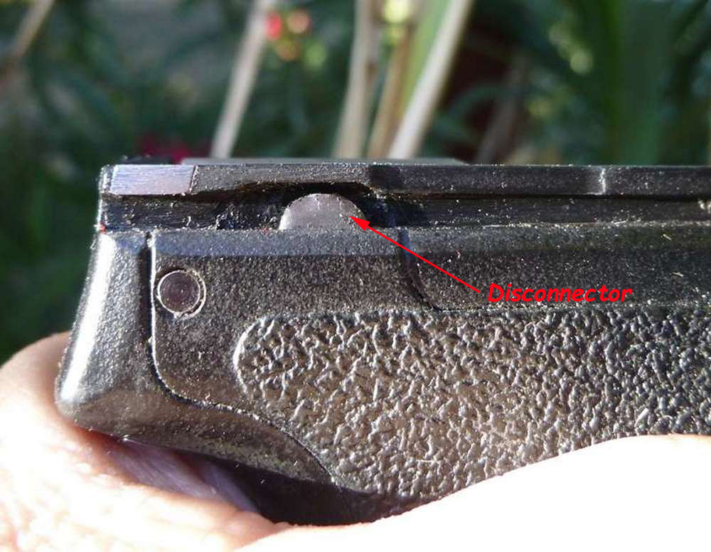

    Take a small tool (screwdriver, butterknife, etc.) and press the disconnector down until the top of it is below the level of the frame, then release it. It should immediately return to it's full height.
    Now pull and hold the trigger. The disconnector should have moved foward from it's previous position. Now, still holding the trigger to the rear, push the disconnector below the edge of the frame. This should allow the cocking cam to reset (you see and hear this happen) and the disconnector should remain down when you pull your tool away. Now, release the trigger; the disconnector should pop back up in it's original position (see photo). There should be an audible click when this happens. Pulling the trigger should cause the cocking cam to move.
    If everything is good to this point, it might be best to remove the slide plate. Let me what you find while doing the above and we will continue.

    One last thing to check before removing the side plate is to see if a magazine is causing any interference with the trigger bar or the trigger bar spring.
    Next, I would look at where the slide and disconnecter interface. On the bottom edge of the slide there is a cutout section that rides directly above the disconnecter when the slide is in battery. This allows the disconnecter to rise to it's full height and engage the trigger bar with the cocking cam. Check this cutout area and the disconnecter for any damage/wear that might interfere with a correct interface/operation of the parts.
    Here's a photo of a slide out of battery that shows the slide cutout. This pistol has a malfunction in that the disconnecter is wedged under the slide. The disconnecter should be riding along the underside of the slide at this point (which would disconnect the trigger bar).
    Also check:
    the side plate for any indication that the trigger bar might be hanging up on it.
    The interface of the trigger bar and cocking cam looking for full engaement
    Might as well give everything a good cleaning everything at this point.
    If you have found nothing amiss, I'd suggest replacing the trigger bar spring.
