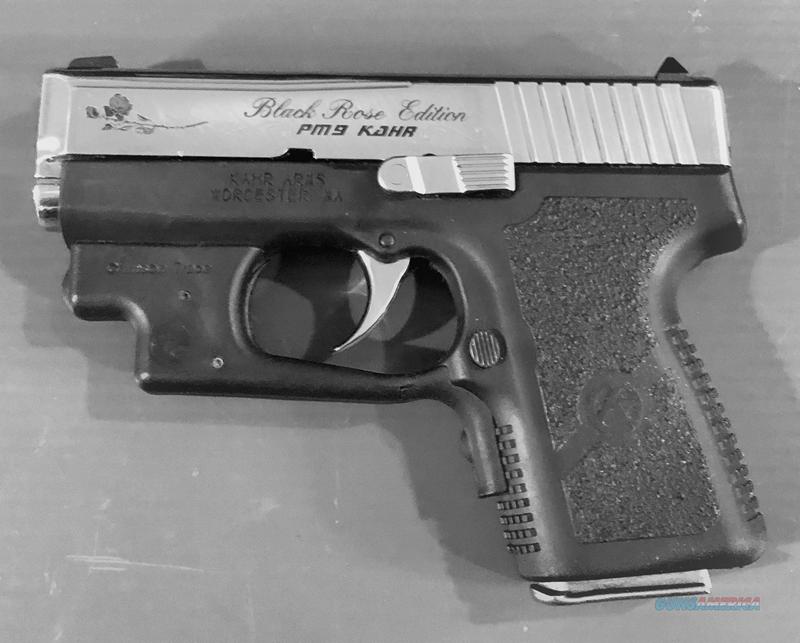

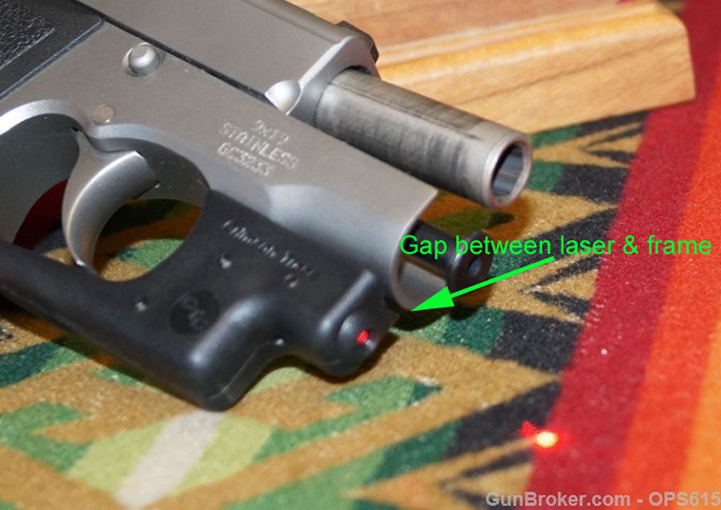

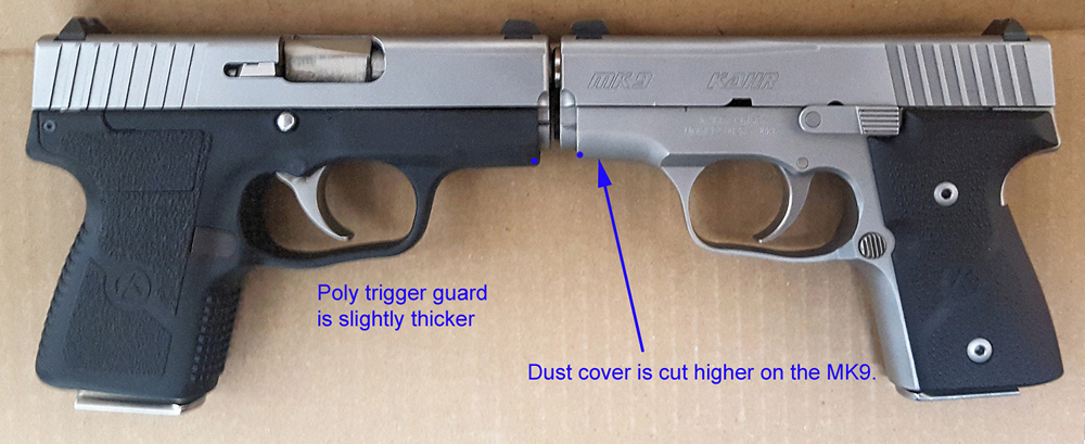

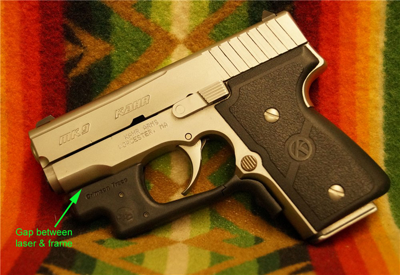

    I think it best to contact the seller of that MK9 to ask how securely that laser is mounted. I say do this because there a some differences between the poly and steel guns other than the materials used.
    The trigger guards are nearly identical in shape between a PM9 and MK9....
    ...but the guard is thicker on the poly gun. I think more significantly the dust cover on the MK9 is cut higher than the cover on the PM9
    This results in a gap between the laser and the frame of the MK9 (I will point out the laser looks to fit tightly to the frame at the top of the trigger guard).
    From the seller's photos:
    Compare that to the fit of the laser on this randomly picked photo of a Black Rose PM9

    Thanks so much for taking the time to provide the side-by-side profiles of the two pistols. Seems the laserguards would be designed to fit snuggly on the thicker poly trigger guard—could be a loose fit on the metal frame MK9.
    I thought about contacting the seller, but decided against it, considering I wouldn’t be purchasing the gun. Perhaps Dao can comment on how secure the LaserMax is on his MK40?
    I think the gap between the dust cover and laser is okay, based on what Crimson Trace wrote in their description of the LG-437:
    *Based on machining variances between pistol models, it is possible that some consumers may experience a slight "gap" between barrel and Laserguard®. This does not affect overall fit and function of the laser sight in any way, shape or form.
