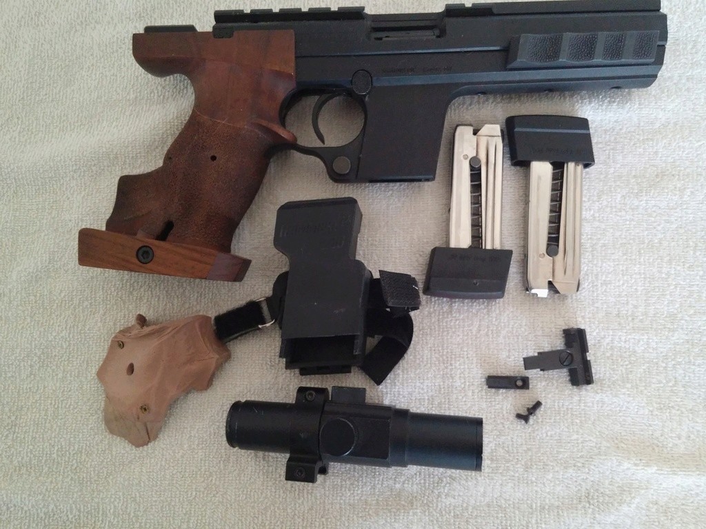

    Yeah, baby. 138lb boar Sunday, a running shot at 110ft- right through the ear-hole! He never felt a thing.
    Having said that, despite that I have really big paws the grip on this is right at the limit of what I can comfortably grasp and I understand the complaint others have made that it's like trying to hang onto a 2x4.
    I was thinking about a re-design alla the old Hammerli Olympic match pistols. What if they re-designed the frame, slimmed the grip way down and moved it back as far as possible, and moved the magazine forward of the trigger. Keep the bolt and action design the same, don't even change the mags. Minor re-design of the fcg to accommodate the change in geometry....
    John
