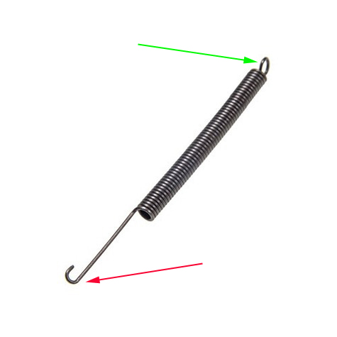

    First, your gun is not operating correctly. Without a magazine in place, the the disconnector should be pushing the trigger bar out of contact with the cocking cam. You should not see the cocking cam moving when pulling the trigger.
    I'm not privy to any information about Kahr manuals and lists beyond what the next person knows. Your guess is as good as mine as to why the parts are not shown in a diagram.
    So let me make a few more guesses:
    The area to the rear of the magazine well (behind the magazine) is solid in my P380. I'm guessing it is not on your P380. I would think there is an area made for the spring and maybe part of the disconnector.
    Looking at this photo of a P380 CA, there is a pin on the grip that is not present on my P380.
    I imagine this pin is there to anchor one end of the magazine disconnector spring...possibly the one I've drawn a green area to in the following photo.
    If I'm right about that then the end with a red arrow probably connects here on the disconnector (another guess).
    Hopefully, your issue is that the spring disconnected and you can put it back in place without needing to disassemble the gun.
    If it's something else, I'm willing to continue with you.
    As to the extractor: on my P380 it is flush with the slide when a round is chambered and recessed when not.

    I removed the slide and looked in the space (only on Cali models) at the rear end of the open end of the grip. On this model, only, the partitioned space in the grip compartment holds a cross-wise small pin to act as an anchor for the magazine disconnect spring (the pin goes through the round end of the spring). I used a small screw driver to make contact with the spring end on the pin AND COULD EASILY slide it back and forth. ie. No tension on it.
    The other end (with the hook) attaches to the magazine disconnect and accessible by removing the side plate to inspect and/or replace. I decided against tackling it myself and will send the gun into Kahr.
    I believe this broken or disconnected spring issue may be rare, however I might think this would make a good 'sticky' to identify effects of a broken spring. Kahr thought is will show as broken versus disconnected as they have dealt with this before. Lastly besides the 'Thanks again' I mentioned to Kahr the lack of thier P380 parts diagram missing an illustration of the pin, spring and connection to both the pin and magazine disconnect. The Kahr rep said he will pass that along.
