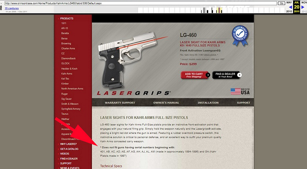

    FWIW, this is from the internet archives:
