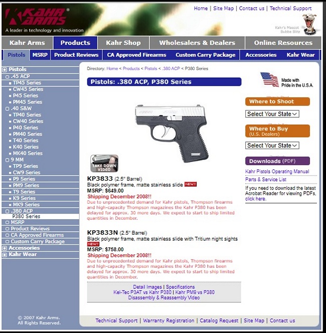

    Was the p380 even produced in 2007 or 2008? Mine is an RAxxxx from the first production run with a BOD of 2010.

    Quote Originally Posted by DJK11 View Post
    I checked the "wayback machine" and found mention of them (after following a "new model" link) being shipped in December 2008
