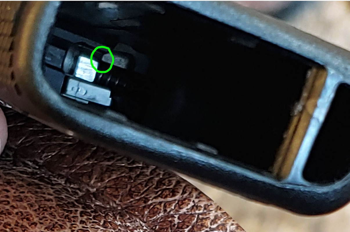

    Hello, it might be a matter of terminology, which I am not good at. Anyway I circled where it is catching when I try to put the slide back on. If I gently twist a flat blade screw driver and get it out of the way, the slide goes home no problem. So this is my first polymer gun, I wonder if polymer guns have their own "personality" and if it shoots good, I can live with this.

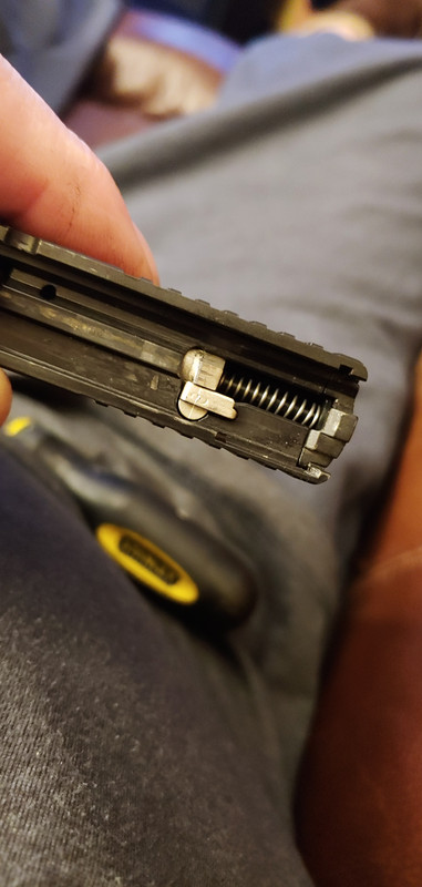

    Here's a view from the top, the ejector almost looks crooked? Is this to be expected? The machining looks a little sketchy. Again, the guns been shot about 20 times with no issues, I bought the gun a few months ago new after waiting two months for it.

    Is the striker safety plunger cracked?

    I see what you mean, but I zoomed in, it looks like a casting seam?
